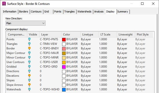

Open the sample styles drawing, Sample_styles.dwg, in C:\Program Files\AutoCAD 2026\C3D\Help\Civil Best Practices Guide. The surface styles are designed to display different components of a surface at different design stages. The surface style assigned to the drawing is called Existing Ground Contours. This is an example of a style that would be used during the design stage of a project.
In the Surface Style - Existing Ground Contours dialog box, the Border, Major Contour, and Minor Contour components are set to visible. These components determine how the surface appears in the drawing. With these components enabled, the surface is displayed as shown in figure 6.
Figure 6: Elevations and slopes are not visible
The following exercise demonstrates how to change the Existing Ground Contours style so that it reflects the Final Grade style. Editing the contour style will demonstrate how to experiment with styles to suit your requirements.
To change the Existing Ground Contour style
  1. On the Toolspace Settings tab, expand the Surface styles collection and double-click the Existing Ground Contours style.
  2. On the Display tab, click the light bulb icons to turn off the Major Contour and Minor Contour components.
  3. Click the light bulb icons to turn on the visibility for the Elevations and Slope Arrows components as shown in figure 7. Keep the Border contour set to Visible.
    Figure 7: Enable the elevations and slopes components
Now the drawing displays borders, elevation differences indicated by color, and slope direction arrows and appears as shown in figure 8. The contour lines are no longer visible. These changes now reflect the components that are enabled for the supplied Finish Grade surface style.
