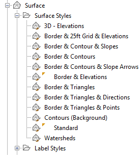

About the Object Style Collection (Settings Tree)
Use an object’s Styles collection in the Settings tree to manage styles for a class of objects.
The following illustration shows an example of a Settings tree object style collection:
Right-click the style collection to display a standard context menu with the following commands:
Select this command...
If you want to...
New
Create a new style.
Refresh
Update the Settings tree display.
Right-click a style name to display a standard context menu with the following commands:
If you want to...
Edit
Change the properties of the selected style.
Copy
Create a new style based on an existing style.
Find References
Locate where styles are used in the current drawing. This command is displayed only when the style is in use.
Replace With
Replace the use of a style with another style. This command is displayed only when the selected style is in use.
Delete
Delete the selected style. This command is displayed only when the style can be deleted.
Refresh
