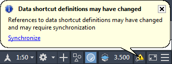

When a drawing contains references to data shortcuts, the
icon is displayed at the bottom-right side of the drawing window.
Data references are synchronized automatically when the drawing is opened. Otherwise, flags appear in the Prospector tree and the status bar of the drawing window when a reference object is out of date.
When references become out of date with the data shortcuts, a message is displayed prompting you to synchronize the references. Click Synchronize to update the references.
If you do not want these notifications to appear, you can click the
icon at the bottom left of the drawing window to turn them off. When notifications are turned off, the icon appears as
