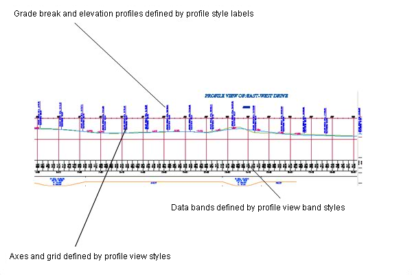

Profile view displaying surface and layout profiles

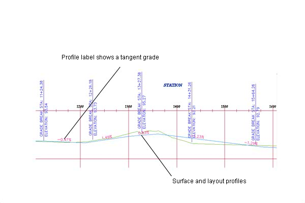

Closer view of surface and layout profiles
