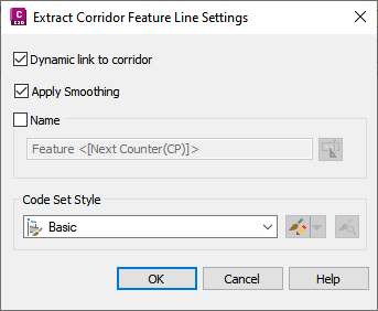

In this example, the Create Feature Line From Corridor command is used to extract the feature line. We can zoom in and select the magenta back of curb feature line.
A best practice is to select the Dynamic Link option in the Extract Corridor Feature Line Settings dialog box, as shown in figure 35, so that in this example, any updates to the corridor will update the grading in this area as well. In addition, there are settings for smoothing to handle the formation of the feature line as it travels around a curved area. For more information, see Feature Line Smoothing.
Figure 35: Selecting the dynamic link option
