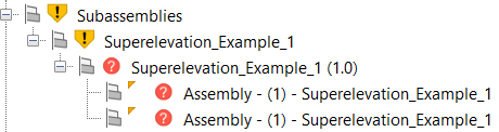

Use this dialog box to update the source paths of subassemblies in the drawing.
You can access this dialog box by right-clicking a subassembly that is displaying the File Not Found icon as shown in the following illustration and selecting the Fix Missing Paths command.
