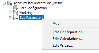

- In the Part Family browser window, right-click the Size Parameters node, and click Edit Values.

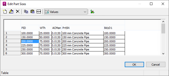

- In the Edit Part Sizes dialog box, find the parameter (property) value(s) you want to edit.
- Edit the values as described below:
Pipe values
- To change values for pipe sizes, select the row and size cell. Double-click to edit.
- To delete a size row, select the row and click the Delete button
on the Edit Part Sizes dialog box. - To add a size row, select the closest size and click the New button
on the Edit Part Sizes dialog box, and then edit the values in the new row.

- In the Part Family browser, right-click the Size Parameters node, and click Edit Values.
- In the Edit Part Sizes dialog box, click the Autosize Column Text button then find the Pipe Inner Diameter (PID) value and the Wall Thickness (WTh) values.
- Select any row in the table and click the New button
on the Edit Part Sizes dialog box. The selected row is copied to the table. - In the new table row, edit the PID and WTh values by double-clicking on them and typing in the new values.
- After you have completed editing sizes, click OK on the Edit Part Sizes dialog box.
