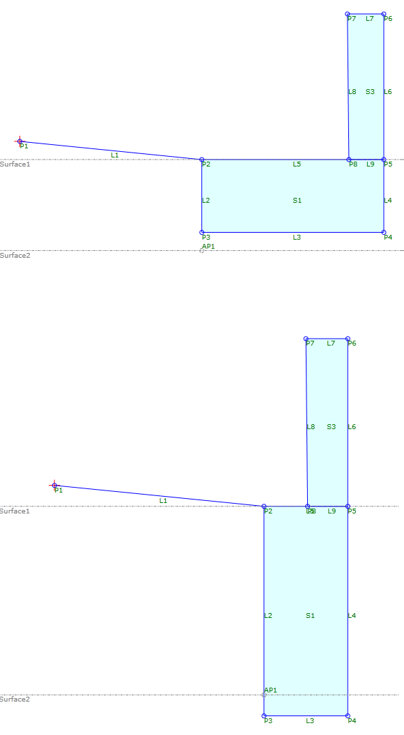

Example
To see an example of how this geometry element is used, open the following Sample PKT file:
Set Variable Value Example.pkt
In this example, variables are used to define the height and width of a retaining wall footer. The height and width of the footer varies depending on the distance between two target surfaces.
- Variables for
Height and
Width are defined.
- The
Decision uses an expression that determines the distance from P2 to Surface 2.
- Depending on whether the distance is greater than or less than 3, the
Height and
Width Variable Values are set in one of two ways.
- The points in the
Footer sequence applies the appropriate
Height and
Width values to create the geometry of the footer.
Note: To test the condition, in the example, change the Preview Value of the Surface2.
