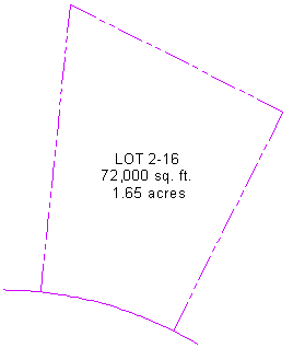

Default label location
Dragged label with leader

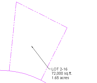

A leader line remains attached to the original insertion point of the label and stretches to the label’s new location. A leader can be drawn with an arrowhead and can be a straight line or a spline curve.

Label text is left-justified when the leader is on the left side of the text and is right-justified when the leader is on the right, as shown in the following illustration.

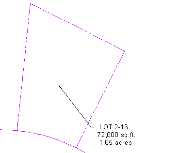

However, you can set the label text to be always left-justified regardless of the location of the leader, as shown in the following illustration.
