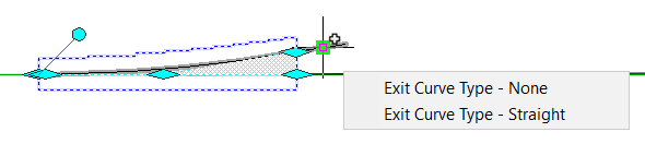

To change the exit curve of the diverted alignment
  1. Click the grip shown below to display the context menu.
  2. Select one of the options to configure the exit curve type.
