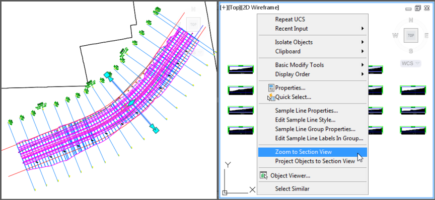

To zoom to a section view from a sample line
  • Right-click a sample line and select Zoom to Section View.

To zoom to a sample line from a section view
  • Right-click a section view and select Zoom to Sample Line.
To zoom to a section view or sample line in a different viewport
If you have multiple viewports set up in your drawing, you can select a sample line or section view in one viewport, click in the other viewport to make it active, and then run the appropriate zoom command.
  1. In a drawing with two viewports, select a section view or a sample line in one viewport.
  2. Click in the other viewport to make it active.
  3. Right-click and select Zoom to Sample Line or Zoom to Section View.
