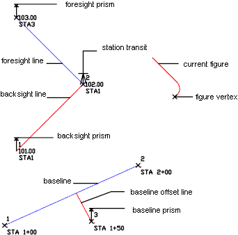

Examples of survey interactive graphics:
