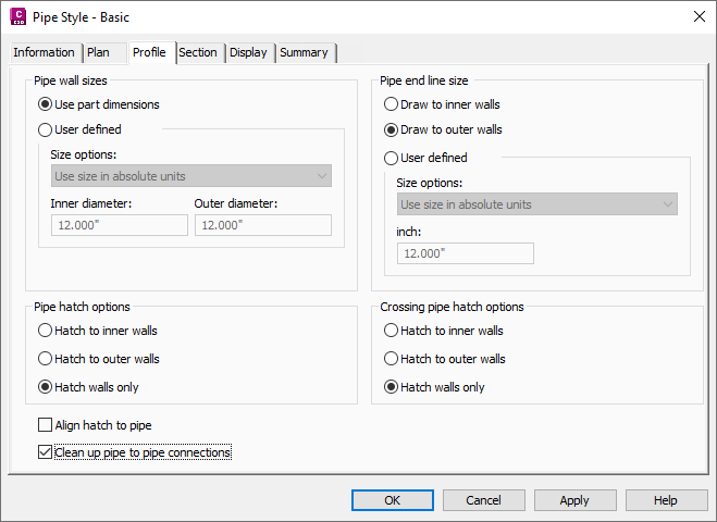

Pipe Connection Display in Profile
Use the Clean Up Pipe To Pipe Connections option in the Pipe Style dialog box, as shown in figure 4, to improve the appearance of pipe profiles so that the pipes graphically appear to line up as expected. This option is not enabled by the default, so you must select it.
To enable pipe clean up
- Select a pipe in the drawing.
- Right-click and click Edit Pipe Style.
- Select the Profile tab in the Pipe Style dialog box.
- Select the Clean Up Pipe to Pipe Connections check box.
Figure 4: Dialog box for selecting pipe connection clean up
