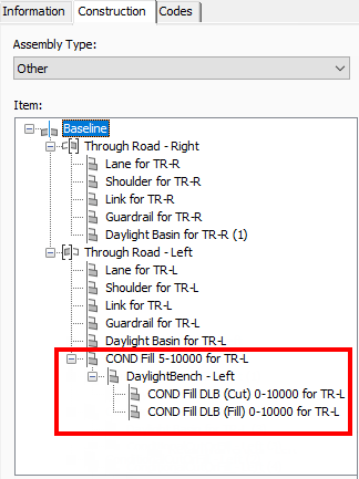

The next step is to assign descriptive names to each of the subassemblies in the conditional assembly. Assigning meaningful names to the subassemblies makes it easier to identify them when you are assigning targets, and helps you to identify subassemblies in the Subassemblies collection in Prospector.
To assign meaningful names to conditional subassemblies
- In the drawing, right-click the conditional assembly and select Assembly Properties.
- In the Assembly Properties dialog box, click the Construction tab.
Subassemblies that are added to the one side of an assembly display the default names, followed by the side to which they were added.
- In the Item list, select the conditional subassembly that is located on the left side of the assembly. Click it again to highlight the text. Change the name so that it indicates the type of condition it is set to detect. In the following example, the name of the first conditional subassembly has been changed to COND Fill 0-5 for TR-L. In this example, COND indicates that this is a conditional subassembly. Fill indicates the type of condition that activates it. 0-5 indicates the minimum and maximum distance value of the fill condition it is looking for. In this example, TR-L is a reference to the name of the parent assembly this particular subassembly is associated with (in this case, “Through Road” or “TR” and “Left side” or “L”.)
- Rename any other conditional subassemblies in the assembly to meaningful names.
- Click OK.
