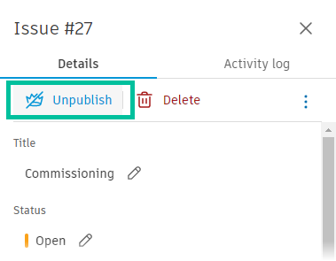

Publish and Unpublish Issues
Issues can be published or unpublished. Published issues will be visible to anyone on your project with the correct permissions. If you unpublish an issue, only the issue's creator and assignee will be able to view it in the Issues tool and on the relevant sheet, document, view, or model.
To publish or unpublish an issue:
  1. In the Issues tool, click the relevant issue from the list.
    The issue opens in the viewer, and the Details tab in the right panel shows if the issue is published or unpublished.
  2. Click Publish or Unpublish to change the issue's published status.
Delete an Issue
You can delete an issue from the issue log.
    The issue opens in the viewer.
  2. Click Delete in the Details tab in the right panel.
Note: All references to this issue will be permanently deleted, including from any sheet, document, view, or model where it has been referenced.
