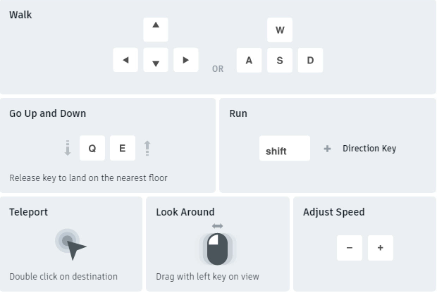

  5. Review the first person navigation controls and click the applicable option to go to the model.
    Tip: The navigation controls are presented each time you use the first person navigation. If you become familiar with the navigation controls, you may dismiss this message in the future.
Now you are placed into the 3D model (as part of the Project Model view) in first person mode at the location and viewing angle selected from the 2D sheet. From here, you can walk around the model or quickly jump back to the previous view to return to the corresponding 2D sheet. While in first person mode, you can't select objects. Exit first person mode to make a selection.
