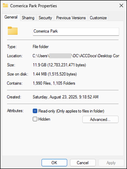

If a single project contains more than 300,000 files and folders, you may notice sync performance slowing down. To see how many files you have in your project:
  1. Open File Explorer
  2. Right-click on the Project folder and select Properties.
    Properties Contains
  3. If the Contains number is more than 300,000 (files + folders) you should consider reducing the size or scope of the project using one or more of the following best practices:
