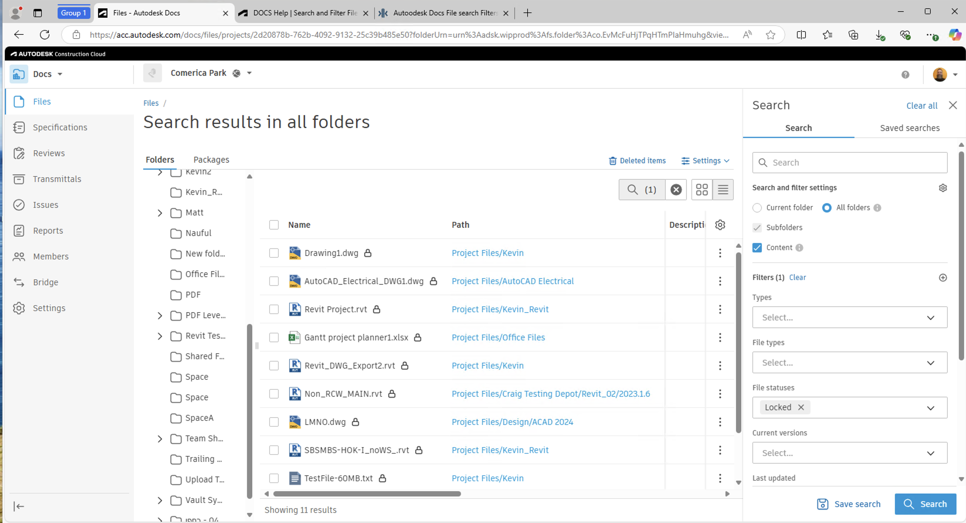

Identifying Locked Files
You can identify all locked files in a Forma project using the search filters on the Forma web client. See the Forma Data Management help page Search and Filter Files for more information.
In the search and filter settings, choose Locked under the "File statuses" section to view all locked files in the project.
