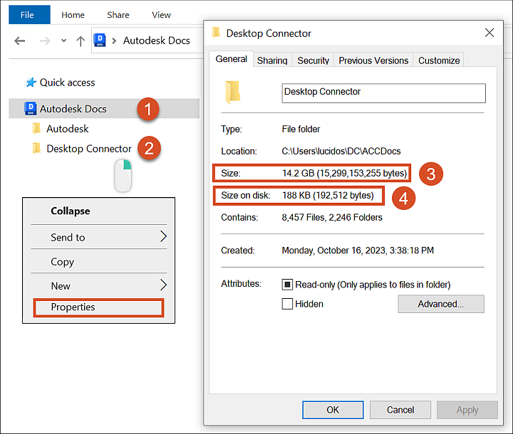

The term "Size on disk" refers to the real disk space used by a file or folder on your computer. It considers the allocation unit size of the file system, which is the smallest amount of space that can be assigned to a file. To view your cloud storage capacity for a project and what has been downloaded to your local drive, follow these steps.
  1. In File Explorer File Explorer navigate to Autodesk Docs.
  2. Move to your project hub Desktop Connector (for this example) and right click and select Properties.
  3. In the Properties window Size:
    • Refers to how large the dataset is in the cloud.
  4. In the Properties window Size on Disk:
    • Shown will be what has been downloaded locally.
