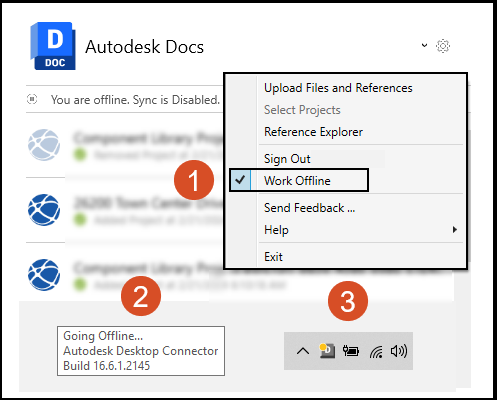

Choosing to Work Offline
Before selecting Work Offline, review the home screen and sync any pending changes.
Right-click the Desktop Connector tray icon Desktop Connector Tray Icon
  1. Select Work Offline from the menu in the home screen.
  2. Your status will change to going offline.
  3. The yellow icon DC Offline will appear in the Desktop Connector tray to indicate you are in Work Offline mode.
    DC Offline
Note:
Depending on your Windows notification settings, you may see a system notification when entering offline mode.
