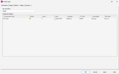

Important: Civil tools require the profile geometry to be visible in the 3D view. In Civil 3D, on the Profile Style dialog > Display tab, select Model in the View Direction drop-down, and then set the 3D Chain component to Visible before uploading to the Files tool.

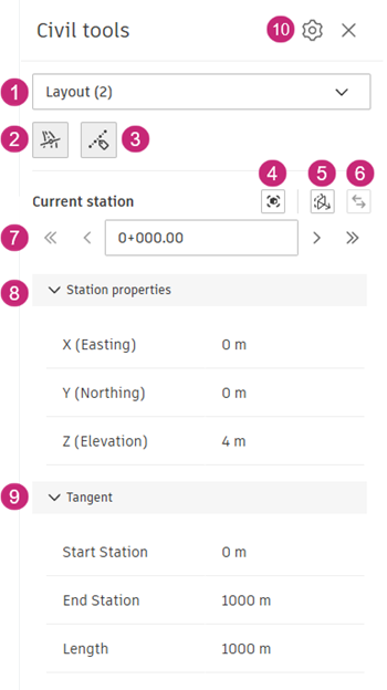

Civil tools panel
  1. Alignment profile list: Selects and highlights a specific alignment profile in the drawing. A list of the project geometry is displayed, organized by alignment and profile, as well as the DWG file that they belong to. Selecting a profile selects the corresponding 3D shape. While 2D profile lines may be visible, the tool works with the 3D geometry. Alignment names provide context to select the 3D geometry.
    Note: Only those DWG files that contain alignment and visible profile geometry are listed, even if you have a view open that contains multiple models from DWG files.
  2. Station tracker icon Station tracker: Displays a highlighted line at the currently selected station that is perpendicular to the alignment. The station is labeled at its position. Selecting this tool shows or hides the station tracker.
  3. Station labels icon Station labels: Displays other stations with labels along the alignment. Labels display dynamically, adjusting to both zoom level and view orientation. Selecting this tool shows or hides the labels.
  4. Zoom to current station icon Zoom to current station: Centers and zooms the current view to the selected station. This tool is enabled when the station tracker is visible.
  5. Cut model geometry icon Cut model geometry: Clip all geometry before the selected station with a perpendicular plane. This tool is enabled when the station tracker is visible.
  6. Reverse cut direction icon Reverse cut direction: When Cut model geometry is enabled, this inverts the clipping plane to all geometry after the selected station. This tool is enabled when the station tracker is visible.
  7. Station navigation: Navigates back (<) and forth (>) between the stations, or to the beginning (<<) and end (>>) stations of the alignment.
  8. Station properties: Displays the easting, northing, and elevation coordinates of the currently selected station.
  9. Tangent: Displays the horizontal geometry properties from the alignment at the current station. This includes the type of curve the current station is in (tangent, curve, or spiral) and relevant details such as radius and length.
  10. Settings Settings: Opens the Civil tools settings panel. Define the station increments along the alignment and specify the station label formatting.

While “alignment” is commonly used to describe linear geometry in Civil 3D, the actual 3D shape represented is the profile, which combines both horizontal and vertical geometry. Because of this, the civil tools require the profile geometry of the drawing to be visible in the 3D view. This is accomplished by setting the 3D Chain to Visible under the Model View settings of the Profile Style in Civil 3D.

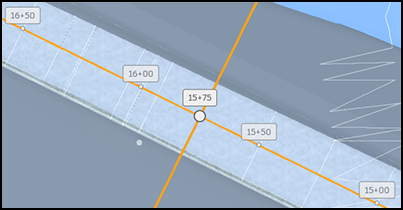

Display stations along an alignment profile
Below the alignment profile drop-down menu, click the Stations labels icon Station labels icon.
Station labels are placed at regular intervals along the alignment profile. This spacing intelligently adapts to the current zoom level and view orientation.
Stations alignment profile

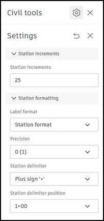

Specify step interval and label formatting for stations
At the top of the Civil Tools panel, click the Settings icon Settings icon. The Settings let you specify station step intervals and label formatting options.
Station formatting

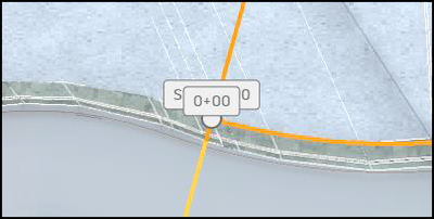

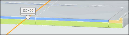

Display the Station Tracker
Position along the alignment can be tracked by defining and editing the current station.
Below the alignment profile drop-down menu, click the Station tracker icon .
The station tracker displays at the beginning of the alignment profile as a highlighted perpendicular line. The station tracker label reports its current station position.
The Station tracker is a means of quickly identifying a specific station and it’s a perpendicular plane to the alignment profile.

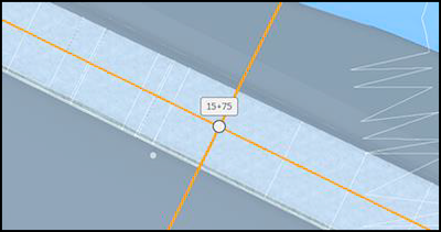

Track stations along an alignment profile
There are several methods to change stations.
  • Manually enter a station in the current station field between the step controls.
    Enter station field
  • Step forward (>) and backward (<) to move the tracker to the next station increment as defined in the settings.
  • Jump to the end station (>>) or beginning station (<<).
  • Click and drag the station tracker to any point along the alignment profile.
    Station tracker point
The tracker always maintains a perpendicular orientation to its alignment profile.

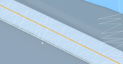

Cut Geometry at Stations
A vertical cut plane, perpendicular to the alignment, can be enabled at the current station. This cut plane, which dynamically updates with the current station value, is only available when the station tracker is visible.
Create a cut plane with a station
  1. Move the station tracker to the location to apply the cut plane.
  2. Click the cut model geometry icon Cut model geometry icon. Any geometry before the current station will be clipped by a plane along the perpendicular station tracker. This lets you see a cross section view of your model to better review and better understand your design.
  3. (Optional) If needed, click the Reverse cut direction icon Reverse cut direction icon to display the geometry before the station and clip the geometry after the station.
Viewing the model with the cut plane lets you access typically hidden features that can be reviewed and measured with the Measure tools.
Tip: While viewing clipped geometry, you can move the current station to adjust the clip plane in real time. This lets you have a more flexible design review process.

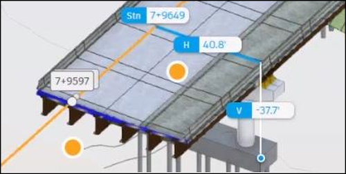

Measure Station Offsets
Station offset measurements can be determined from a selected point in your project geometry. The Station Offset tool is available in the Measure tools of the Viewing toolbar when viewing Civil 3D drawings.
To view offsets to a station from a point:
  1. In the Viewing toolbar, click Measure Measure icon and then Station Offset Station Offset icon.
  2. In the drawing, click a point along an object to be measured.
The Station Offset measurement shows the closest station point (Stn), and the horizontal (H) and vertical (V) offsets from that station to the selected point.
Station offset
The measurement units follow the unit settings in the measurement toolbar.
