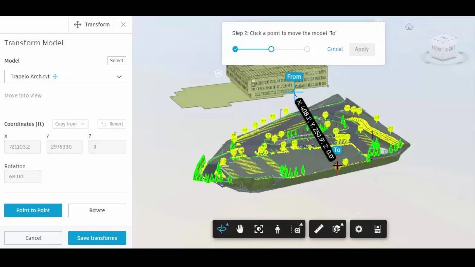

  6. Click Point to Point to move the selected model by picking specific points:
    1. First, click a point on your selected model. This point is used as the reference point to move the model from.
    2. Next, click a point on another model. This point is used as the position that you want to move your selected model to.
    3. Click Apply to align the two points by moving your selected model.

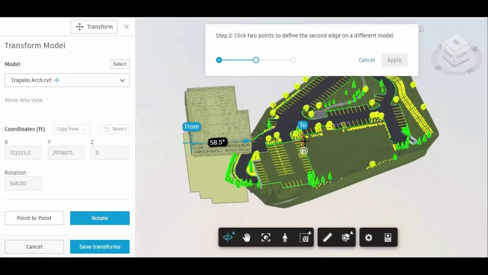

  7. Click Rotate to rotate the selected model by aligning two edges:
    1. First, click two points on your selected model to define an edge.
      Tip: The order that you click the two points defines the direction of rotation. After you select the first point, move your cursor to display an arrow. The arrow indicates the direction of rotation based on the position that you select for the second point.
    2. Next, click two points on another model to define the second edge.
      Tip: The order that you click the two points defines the direction of rotation. After you select the first point, move your cursor to display an arrow. The arrow indicates the direction and angle of rotation based on the position that you select for the second point.
    3. Click Apply to rotate your selected model so that the two edges align.
