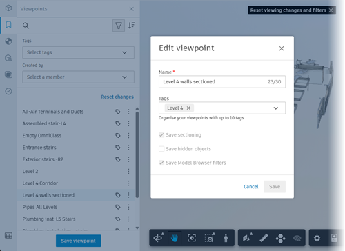

You can rename or add tags to a viewpoint at any time:
  1. In Model Coordination, open the Views tool and open the view that your viewpoint is created against.
  2. In the viewer, click the Viewpoints tab .
  3. In the Viewpoints panel, click the more menu next to the viewpoint you want to edit, and then click Edit.
  4. Enter a new name or add tags as required.
  5. Click Save to apply the changes.
