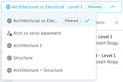

Open in the viewer
  1. Use the Views drop-down list to switch between views while in the viewer:
  2. Click the X icon at the top-right of the viewer to return to the Views tool.
