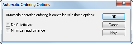

Automatic Ordering Options dialog
Click the Automatic Options button to open the Automatic Ordering Options dialog:
This dialog contains options suitable for Wire EDM:
  • Do Cutoffs last — All retracts are done together, then cutoffs, then contours
  • Minimize rapid distance — This minimizes movement of the wire by moving to the next closest feature after the one it is currently cutting
If the Don't ask at tool path simulation option is deselected, the Ordering dialog is displayed when you start simulation, as a reminder about ordering.
