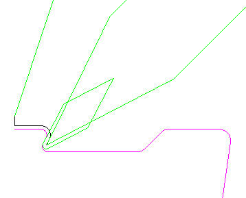

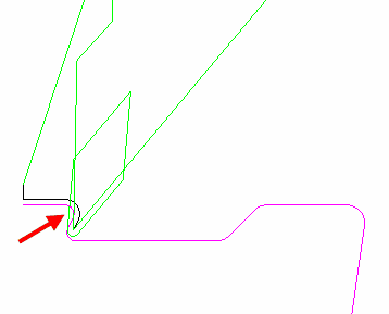

  • Vertical tool
    Using a vertical tool, the tool collides with the part as shown:

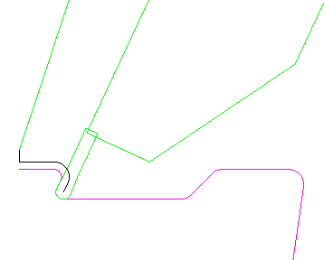

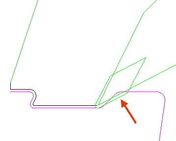

  • Neutral tool, fixed B axis
    Using a neutral tool with a fixed B axis, the tool copes with the undercut part of this example:
    However, it collides further along:

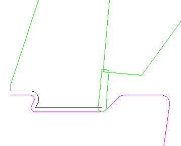

  • Simultaneous B-axis tool
    Using the simultaneous B-axis option, the tool can cut the entire part without colliding, because it can move in the B-axis as it cuts:
