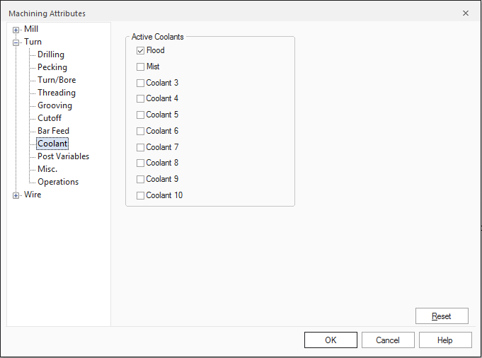

Use the Coolant page of the Machining Attributes dialog to specify the default coolants to use for an operation.
Select the coolant types you want to use. The available coolant types are specified in the CNC file using the Coolant dialog in XBUILD.
You can override this option for a tool using the Coolant tab of the Tool Properties dialog, or for an operation using the Coolant tab of the Feature Properties dialog.
