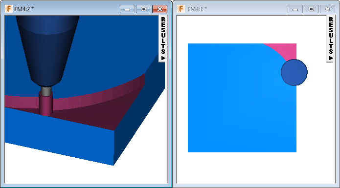

You can play a 3D simulation with two different views at the same time, for example:
  1. If the current window is maximized, click Restore Down on the window's control bar (in the top-right).
  2. Select View tab > Window panel > New.
    A new window is displayed in front of the original window.
  3. Select View tab > Window panel > Cascade > Tile Vertically to arrange the windows.
  4. Use one window to display a zoomed in detail view of an area, and the other window to display the whole view of the part.
  5. Play the simulation.
    The simulation plays in both windows at the same time.
