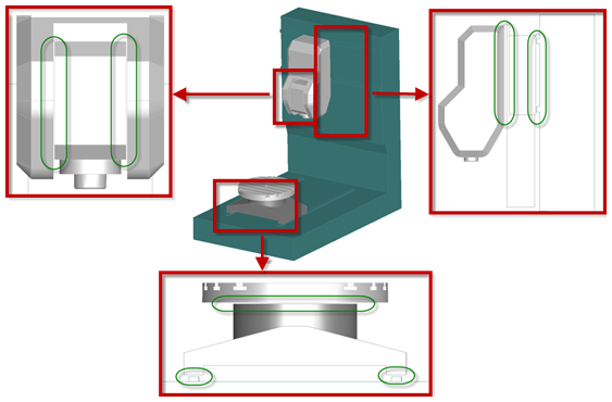

The image shows some examples of clearances. They are not much larger than 2mm each.
