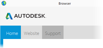

Browser
The Toolbox contains a Browser.
To display the Browser, click the Browser tab inside the Toolbox window.
The Browser contains information on the latest features available in FeatureCAM, including example files that you can load straight into FeatureCAM. To load an example project from the Browser, click the preview picture.
