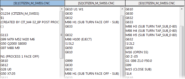

    When a single NC Program file contains multiple channels, the Multi-Channel Editor recognizes the delimiters which denote the different channels. For example, the file below is split into three channels using the delimiters $1, $2, and $3:

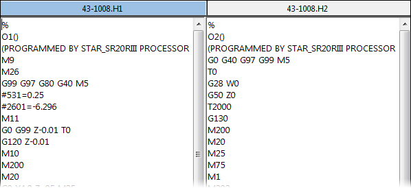

    When multiple NC Program files each contain a separate channel, the Multi-Channel Editor shows each file in its own channel. For example, the two files below, H1 and H2, are each shown in their own channel:
