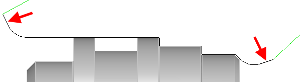

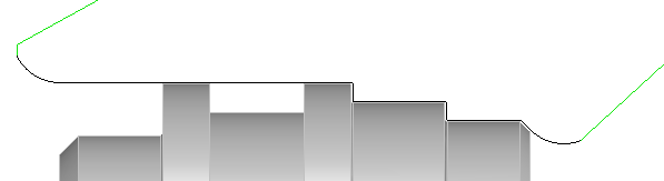

This example uses Arc in and Arc out:
When using Arc in and Arc out with TNR Comp enabled, small linear moves are added to the toolpath before the arc in and after the arc out. Compensation is turned on during the linear segments:
