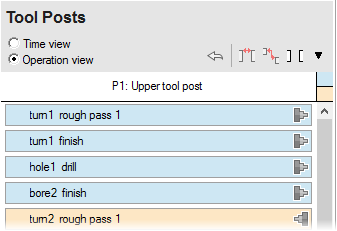

Tool posts report - operation view
Use the Operation view to show the operations in the order they are machined.
Operations are displayed beside the feature names in columns organized by tool post and spindle.
Drag and drop operations within the grid to change their order or tool post.
Use the toolbar at the top-right of the Tool Posts panel to control the order of the operations:
Undo sync code changes — Click this button to undo changes you made to operation syncs. This does not affect tool post changes.
Set sync at oper start — Select two operations and click this button to sync the start of the operations.
Set sync between 2 selected operations — Select two operations and click this button to start the second operation after the first operation has finished.
Remove all oper sync points — Click this button to remove sync points from all operations.
Expand the list to display these additional options:
  • Set opers to tool post — Move the selected operation to another tool post.
  • Reset all opers to default tool post — Undo all changes you made moving operations between tool posts.
  • Reset selected opers to default tool post — Undo all changes you made moving the selected operations between tool posts.
The spindle icons show which turret has control of each spindle. indicates this tool post has control of the main spindle. indicates this tool post has control of the sub spindle. The active operation on that tool post is responsible for setting the spindle speed and direction.
