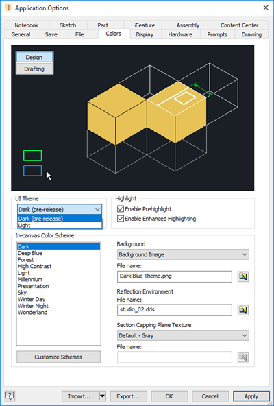

    1. On the Tools tab Options panel, click Application Options.
    2. In the UI Theme section, click the drop down and choose Dark (pre-release). The UI theme is applied.

  • A new Dark color scheme with complementary color values is added.
  • The color scheme Light Theme was renamed to Light to help distinguish it from the UI Theme.
