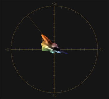

Dolby CtCP vectorscope: Displaying colours in absolute units, the chroma axes from Dolby's ICtCp colour space (also part of Rec.2100). This space was specifically developed for HDR video applications.
Dolby CtCp Vectorscope

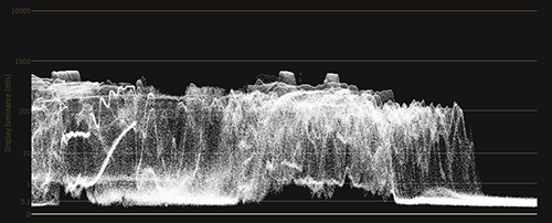

PQ waveform: Displays the luminance of a video signal in units of nits, with the vertical axis scaled with the SMPTE ST-2084 PQ function. For each Waveforms, you can select between the following modes: Red, Green, Blue, RGB, RGB Parade, Luminance - Colours and Luminance - Mono, and can set the signal intensity, from the Preset Widgets tab of the Scopes Settings.
PQ Waveform
