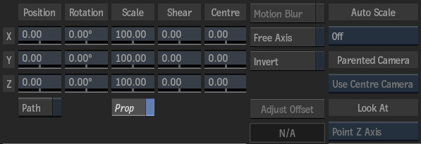

Axis Menu Settings
When accessing Action as a Timeline FX, you have access to a quick menu with some of these Axis settings. To see the full Axis menu, click the Editor button to enter Action.
Axis Tab
X Position field
Displays the position of the X axis. Editable.
Y Position field
Displays the position of the Y axis. Editable.
Z Position field
Displays the position of the Z axis. Editable.
Motion Path button
Enable to animate the position of the axis using a spline drawn in the scene. Disable to animate the position of the axis using explicit animation.
X Rotation field
Displays the rotation of the X axis. Editable.
Y Rotation field
Displays the rotation of the Y axis. Editable.
Z Rotation field
Displays the rotation of the Z axis. Editable.
X Scale field
Displays the scale of the X axis. Editable.
Y Scale field
Displays the scale of the Y axis. Editable.
Z Scale field
Displays the scale of the Z axis. Editable.
Proportional button
Enable to change the fields proportionally.
X Shear field
Displays the shear of the X axis. Editable.
Y Shear field
Displays the shear of the Y axis. Editable.
Z Shear field
Displays the shear of the Z axis. Editable.
X Centre field
Displays the centre of the X axis. Editable.
Y Centre field
Displays the centre of the Y axis. Editable.
Z Centre field
Displays the centre of the Z axis. Editable.
Motion Blur button
Enable to use a motion blur effect for the selected axis (can only be used once the global Motion Blur is enabled in the Setup menu).
Free Axis button
Enable to ignore transformations from parent axes.
Invert button
Enable to invert numerical Axis menu settings. This does not affect settings of nodes connected to the Axis.
Adjust Offset button
Enable to set the current frame as a reference frame that has no transformation data.
Reference Frame field
Displays the frame number of the reference frame that has no transformation data. Non-editable.
Autoscale option box
Select whether to autoscale when Position settings are changed relative to the camera (On Position Changes), or when Position, Rotation, Shear, or Centre settings are changed (On All Transforms).
| Select: | To: |
| Off | Not use autoscaling on the image. |
| On Position Changes | Preserve the projected size of the image by automatically scaling when changing any Position parameters that affect the depth of the image relative to the camera. |
| On All Transforms | Preserve the projected size of the image by automatically changing Position, Scale, and Centre parameters (when any Position, Rotation, Shear, or Centre parameters are changed). |
Parented Camera box
Select which camera is used for the parenting offset when the immediate parent is a stereo camera. Choose left, right, or center camera. Active only when there is exactly one parent that is a stereo camera, or if a look-at connection is attached between the axis and the stereo camera.
Point Axis box
Select which axis is pointed to the attached look-at object. Available only when objects are attached with a Look At connection.
