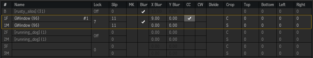

The Media list allows you to easily add and edit the following effects and tools to your clips. The same media can be applied to multiple surfaces, so any effects that you apply to one instance of media is applied to all the surfaces for that media. For example, if you blur media, all of the surfaces using that same media are blurred.

Lock and Slip
Use Slip to create a timing offset for your clip and Lock to lock media at a certain frame.
  1. In the Media list, drag the slip field for your chosen media.
    A positive value starts the clip at the specified frame. A negative value creates a freeze frame effect where the first frame of the clip is held by the specified number of frames.
  2. To lock the media at a certain frame, drag the Lock field to the desired frame number, or click the Lock field to display the calculator to enter a frame number. Ctrl+Alt click the field to return it to Off.

Blur
You can quickly add Gaussian blur along the X and Y axes in the Media list, or enter the full Blur editor to have access to all blur settings, including other blur types, such as Radial and Defocus.
  1. In the Media list, drag the X or Y blur values to apply a Gaussian blur, or double-click the corresponding Blur field for your chosen media to enter the full Blur editor.
    Tip: Alt-drag over a front or matte X or Y Blur field to change both values proportionally; or press Alt+Shift and drag over any front or matte blur field to change all four fields proportionally.

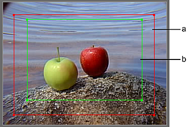

To crop gesturally in the image window:
  1. Double-click the Crop field to enable Crop and Softness.
  2. In the View box, select Media Front or Media Matte.
    The clip appears in the image window with a red outline, which indicates the Crop box, and a green outline, which indicates the Softness box.
    (a) Crop box  (b) Softness box  
    Tip: You can use two viewports to view the crop interactively on both the front and the matte clips.
  3. Set the corners of the Crop box and Softness box by dragging either the corners or edges of the red and green outlines.
    The crop and softness values in the Media list are updated as you drag.
  4. Click Result.
    The cropped media appears in the image window, and the front and matte clip share the same crop.
