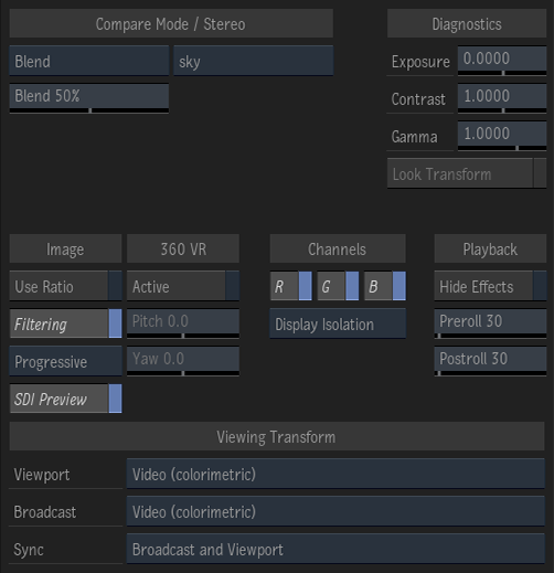

Viewing Settings tab
Compare Mode /Stereo
Compare Modes box
Select the comparison mode to compare the current frame to a grabbed reference frame. Use the Reference box to select a reference frame.
Reference box
Grab a frame to create a new reference frame or select a reference to use in the comparison.
Use Ratio button
Enable to simulate rectangular pixel display that corresponds to the delivery format.
Filtering button
Enable to set the filtering.
Scan Mode button
Adjusts the display to the desired scan mode format.
Playback
Hide Effects button
Enable to hide effects during playback. Disable to display effects (may affect performance).
Preroll field
Displays the number of preroll frames when playing a clip. Editable.
Postroll field
Displays the number of postroll frames when playing a clip. Editable.
360 VR button
Enable to activate the SDI Preview.
Pitch Slider
Use to modify the longitude of the 360 VR Viewer.
YAW Slider
Use to modify the latitude of the 360 VR Viewer.
Exposure, Contrast, and Gamma
Exposure field
Displays the exposure that is used to transform image display in the image window. Editable.
Contrast field
Displays the contrast that is used to transform image display in the image window. Editable.
Gamma field
Displays the gamma that is used to transform image display in the image window. Editable.
Enable Look Transform button
Toggles the dynamic look of a colour transform on and off. Available only when the selected viewing transform has dynamic look operators defined. Editable.
Channels
Red Channel button
Enable to display the red channel of the clip. You may press Shift+R to enable and Shift+R again, or Shift+Z, to disable.
Green Channel button
Enable to display the green channel of the clip. You may press Shift+G to enable and Shift+G again, or Shift+Z, to disable.
Blue Channel button
Enable to display the blue channel of the clip. You may press Shift+B to enable and Shift+B again, or Shift+Z, to disable.
Isolation button
Use Source Isolation to isolate the selected channel as a grey scale image, then apply the viewing transform. Use Display Isolation to isolate the selected channel(s) after the viewing transform (this is equivalent to turning off channels in the display itself). You may press Shift+X to toggle between the two modes.
Viewing Transform
Graphics Monitor Viewing Rule box
Select the Viewing Rule to use for the graphics monitor viewport.
Broadcast Monitor Viewing Rule box
Select the Viewing Rule to use for the broadcast monitor.
Viewport and Broadcast Synchronization box
Broadcast and Viewport synchronizes the Viewing Transform of both the Viewport and the Broadcast, across Multi- and Player views. Do Not Sync allows you to assign a Viewing Transform to the broadcast monitor that differs from the one assigned to the Player views.
- The Colour Management settings (Exposure, Contrast, Gamma) of a viewport are bypassed in the Broadcast Monitor when Viewport Monitoring is enabled in the Broadcast Monitor preferences, and the Bypass option is enabled in the viewport.
- The selected Viewing Transform of a Player view is now shared between its different tabs (Source, Sequence, Container, Batch) even if "Do not Sync" is the selected option.
