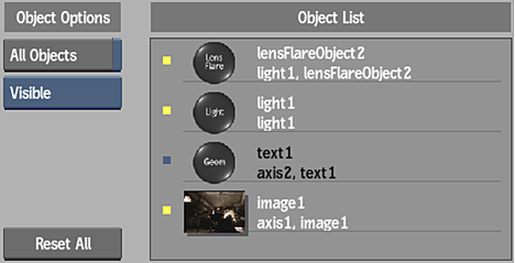

You can select objects to include in your output by using the Object Options and Object List, or the Edit Output mode. Objects that are part of an output are displayed in the Object List. For each selected object, you can decide if you want it to be visible in the final render or not. Non-renderable objects, such as cameras, are always included in outputs.

  1. In the Object List, click an object.
    Selected objects are highlighted in the Object List, schematic, and image window.
  2. To select additional objects, Ctrl-click another object.
    Note: When you select multiple objects with different visibility settings (Visible or Occluded), Mixed is indicated in the Visibility box.

  1. In the Object Options, enable All Objects.
    All objects in the scene, as well as any object you subsequently create, are included in the selected output.

  1. Select an object from the Object List.
  2. From the Visibility box, select one of the following:
Occlude Only
Renders the object as black, excluding it from the shading effect. The result is a perceptual hole where the object was originally located.
Visible
Renders the object in the final render.

Object Options
All Objects button
Enable to output all objects in the Object List.
Visibility box
Select a visibility option for the selected object.
Reset All button
Click to set all objects to Visible mode in the Object List.
