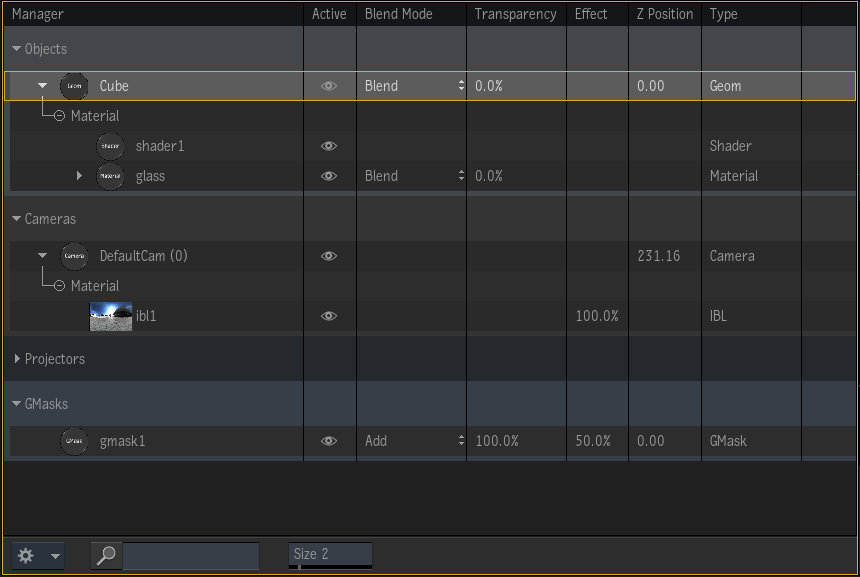

About the Manager View
The Manager view provides you with a clear listing of all the objects found in an Action scene, organized in a hierarchy that mirrors the Action schematic. The Manager view, or Manager for short, reduces the complexity of a scene by making it easier to identify and select an object using its name.
The Action Schematic remains at the heart of Action for anything related to object connections and relationships. The Manager simplifies everything else.

The Manager groups objects by how they're rendered in the scene:
Objects
Groups geometries, including Surface, 3D Text, 3D Shape, Geom, Particle Generator, FBX ABC scenes. An object affected by a GMask link has a GMask section that appears beneath it. This allows you to quickly see what GMasks affect a specific Selective or Surface.
Lights
Light nodes in the scene, including attached Lightbox and Lens Flares.
Cameras
Camera, Perspective Camera, and Camera 3D object, including attached IBL and Matchbox.
Projectors
Displays every Projector object.
GMask
Displays every GMask in the scene.
If an Axis has multiple children, the Manager displays this Axis as a parent of the objects. You can collapse this Axis as a section, change its name, and select it to make it the primary selection for editing. This makes any large geometry structure much easier to navigate and manipulate.
If an object has more than one parent, that object appears under both parents.
