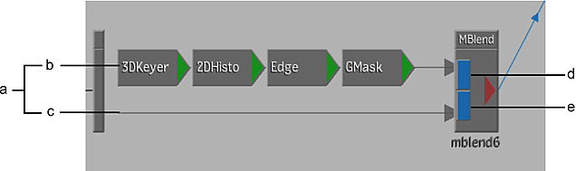

The Front and Matte pipes of the MBlend node are both designed to result in a matte. This is represented visually by a blue box at the right of the Front and Matte pipes. You can place any node on the Front and Matte pipes that results in a matte, including the 3D Keyer, MasterK, 2D Histogram, GMask, Edge and Degrain nodes.
The Front and Matte pipes of the MBlend node constitute one layer.
(a) One layer (b) Front pipe (c) Matte pipe (d) Blue box of Front pipe (e) Blue box of Matte pipe
The two pipes together, along with a back component, constitute one layer. For the first (bottom) layer, the MBlend node uses a pure black image for the back component.
