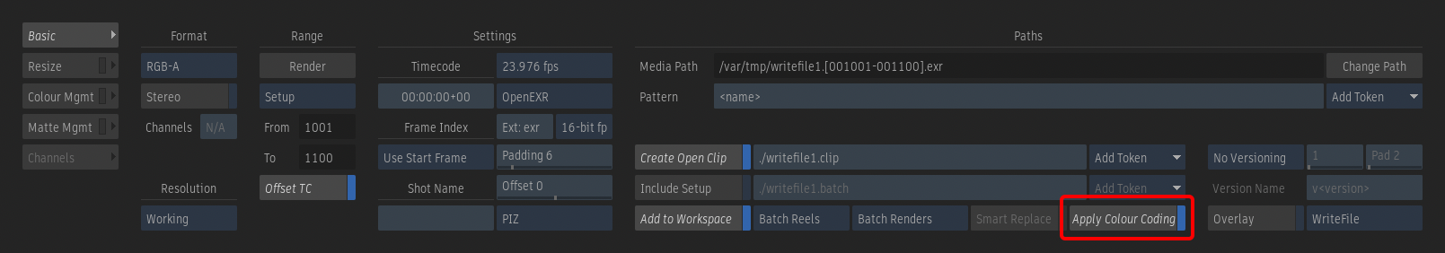

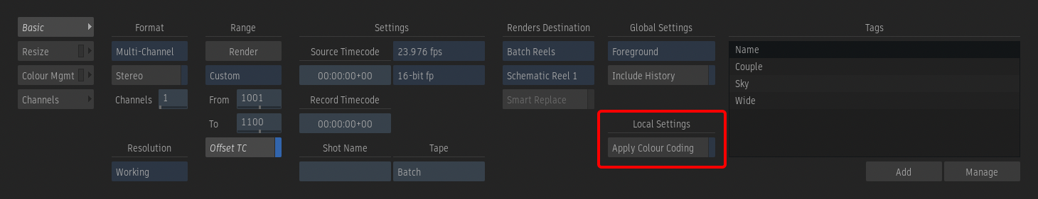

The colour coding of a Render or Write File node can be propagated to the clips originating from them using the Render or Add to Workspace functions. This can help identify from where a clip was rendered. To apply the colour coding to a rendered clip, enable the Apply Colour Coding button in the Local Settings section of the Render node or Add to Workspace section of a Write File node.
Note: The default status of the Apply Colour Coding button for every new Render and Write File nodes can be set using the Apply Colour Coding on Clip setting in the Batch and Batch FX Preferences.
The Apply Colour Coding button in the Render node
The Apply Colour Coding button in the Write File node
