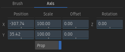

Precisely Editing Strokes
You can also use numeric fields to the Position, Scaling, and Rotation of the selected stroke by using the fields in the Axis tab.

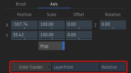

Tracking Strokes
You can track strokes using the Tracker tool in the Axis tab.
  1. In the Edit list, select the strokes that will follow the track.
  2. Click Axis to display the Tracker tool.
  3. From the drop-down menu, select the layer to track. This can be the Front of the clip (LayerFront), or any other source attached to the Paint node.
  4. Click Enter Tracker to enter the Tracker module.
  5. Track the shot. Exit the Tracker module when done.
    Back in the Paint node, the track is applied to the strokes.
After the track, use Offset X and Offset Y to offset the strokes without affecting the position information gathered from the Tracker.
Note: The X and Y Position settings of the source used for a Reveal inherit the same tracking offset as the strokes. This makes sure the reveal strokes and the source are synchronized.
Track by absolute or relative position. Before entering the Tracker, you can select how the tracking data is applied to the selected strokes.
  • Absolute: The Edit Box and selected strokes are moved to the position of the pixel used in the Tracker's Reference box.
  • Relative: The Shift information from the Tracker is applied to the Edit Box and the selected strokes.
