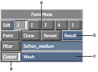

Special Effects media can be brushed onto the image in Canvas mode. You can also apply the Wash, Shade, and Reveal media to the entire image using the Wipe command. See Wiping Using Special Effects Media and Filters. Only one media type can be used at a time.
Use the media buttons to enable some Special Effects media, for example, the Clone and Reveal media. Other media types, such as Drag and Smear, are enabled using the Custom Media box.
(a) Special Effects Media buttons (b) Reference box (c) Custom Media box
