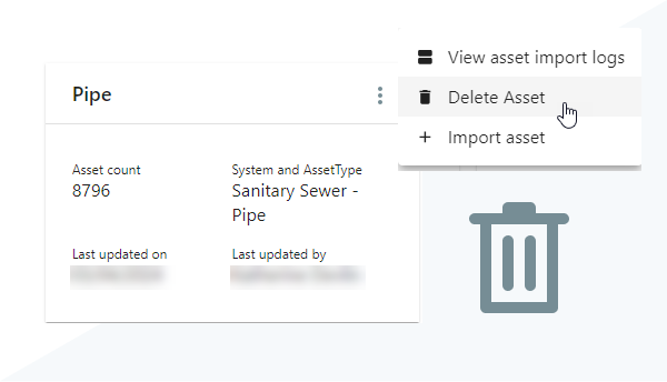

June 25 | You can now delete all assets of the same type (pipes, manholes, etc.) if you are an Admin with a full-access subscription.
If you imported incorrect or test data into Info360 Asset or mapped fields incorrectly during import, you can remove assets in bulk and then re-import them.
Note: It is currently not possible to delete specific assets. See the workaround in Delete Assets in Bulk.
Important:
  • Custom tables associated to the asset type will also be deleted. You will need to re-import these after you re-import your asset layer.
  • Any risk model components or rehab tree queries that use custom tables will need to be re-configured after you re-import your asset layer.
  • You should re-run any risk models or rehab queries for the asset type after re-importing.
  • Inspections, work tasks, and events will be re-linked automatically when you re-import your asset layer.
