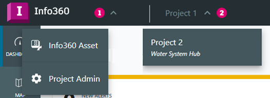

[1] To access project administration, where you can create and manage projects, click on the the product switcher arrow in the top left of Info360 Asset.
[2] To switch between projects (if you have more than one), click on the arrow beside the project name.
