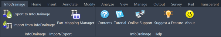

Once installed the plugin will automatically add in the required ribbon when Autodesk® Civil 3D is launched. This will provide the following ribbon:
The commands are:
Export to InfoDrainage - Export one or more pipe network(s) in the drawing to an IDDX file for use in InfoDrainage.
Import from InfoDrainage - Import one, or more phases as pipe network(s) with in the drawing.
Part Mapping Manager - View the mappings that will be used to import/export the information.
Contents - Opens the InfoDrainage for Civil3D Help contents page.
Tutorial - View the InfoDrainage for Civil3D tutorial section of the Help.
Online Support - Provides a link to our Support portal so that support tickets can be logged and viewed.
Suggest a Feature - Provides a link to the Autodesk Water feedback portal.
About - The about form for the software giving information on the software version as well as the license being used.
License Selection - Opens the License Selector.
