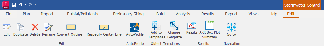

Stormwater Control
The Stormwater Control (SWC) tab is activated when a SWC is selected on the Plan.
Edit
Edit - Edit selected object details.
Duplicate - Duplicate selected object.
Delete - Delete selected object.
Rename - Rename selected object.
Convert Outline - Convert the outline to another shape for the selected object.
Respecify Center line - Respecify the center line for the selected object.
AutoProfile
AutoProfile - Create AutoProfile flow paths to the selected object.
Templates
Add to Templates - Add selected object to Object Templates.
Change Template - Edit Templates list.
Results
Results - View the results of the individual items (if available).
ARR Box Plot Summary - Displays the ARR Box Plot Summary for the selected item (if available).
Navigation
Go to - Go to the selected object in the Plan.

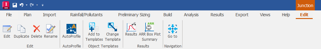

Junctions
The Junction tab is activated when a junction is selected on the Plan.
Edit
AutoProfile
Templates
Results
Navigation
