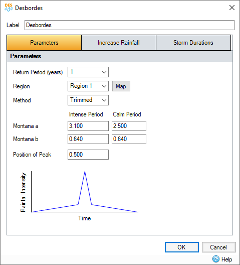

Parameters
Return Period (years)
The software contains the Montana coefficient values for the 4 return periods specified in the original guidance document (Instruction Technique 77) - 1, 2, 5 and 10 years. However 'Custom' can be selected to enter your own return period if you wish to enter your own coefficient values for another return period.
Region
Select which area of France the site is located in (according to the subdivision shown in the Instruction Technique 77). The Map button allows this to be selected graphically by hovering over the region required and left clicking.
French Region Picker
Method

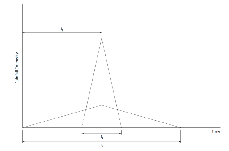

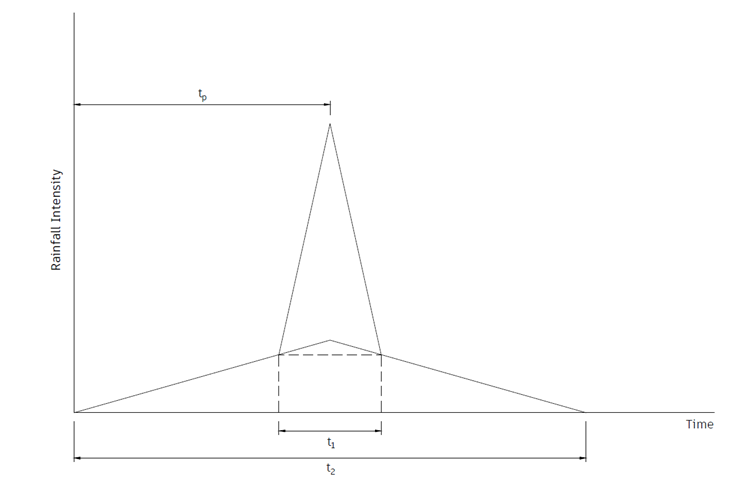

Allows you to pick the intense period starts, as follows:
- Extended - The intense duration is enforced at the points where the intense triangle intersects with the calm triangle.
- Trimmed - The intense duration is enforced at the bottom of the intense triangle. Note that due to the intersection with the calm triangle, the intense triangle has a slightly narrower width.
Coefficients a and b
There are two sets of a and b coefficients, one for the shorter intense period triangle and the other to describe the overall duration triangle. These are automatically assigned for the built-in 1, 2, 5 and 10 year return periods (as given in the Instruction Technique 77), for other return periods they need to be entered manually. However any value may be over typed if a known value(s) has been supplied, most likely from Meteo France. The calm period values for a and b default to values approximately equivalent to a 0.5 year return period.
Position of Peak
This parameter describes the position of the peak of the intense period triangle within the whole event duration. By default a value of 0.5 is selected which means that the peak is in the middle of the storm (symmetrical hyetograph). The specified value applies to all the selected durations.
