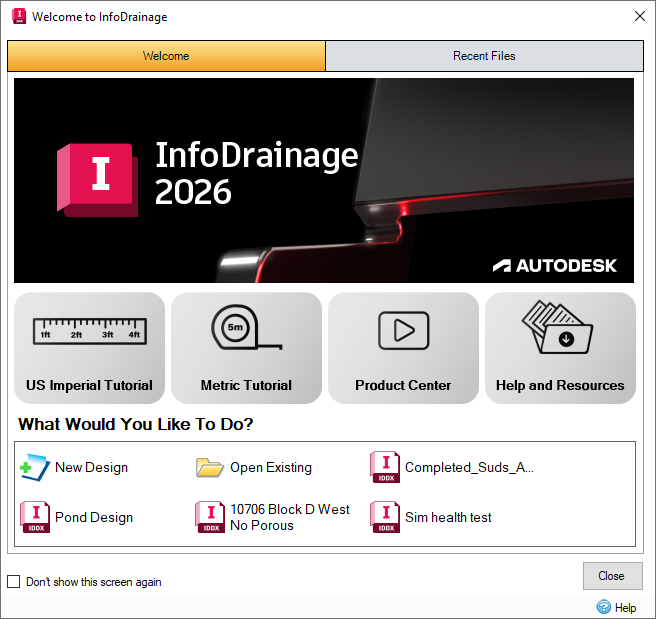

Welcome Screen
Once a license is setup this is the screen we see when opening InfoDrainage. Within the Welcome tab is the ability to access the tutorials (both Metric and Imperial). There are also links to recent webinars, as well as our Help and Resources webpages. The What Would You Like To Do? window displays other actions you can take, such as starting a new design or opening an existing file. Recent Files that have been opened are also listed in this window to allow users to jump back into projects they have been working on. The Recent Files tab lists the recent files in more detail, showing the file path, as well as the date that the document was last saved.

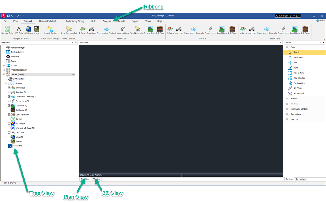

Main Screen
This is the main screen of InfoDrainage that is visible when creating and analyzing networks. The main parts are seen below:
Plan View
The area in the center of the screen is reserved for the 2D Plan View – it shows the graphical layout of the site and it is the main window for creating and editing drainage designs. The location of Stormwater Controls (SWCs), Inflows, Inlets and Outlets can be specified graphically as well as drawing SWC areas and connecting items with Connections.

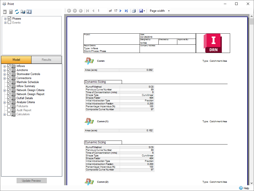

The Print tool displays the preview of the document, as well as different options available when outputting the model to a printer or file. You can modify the settings using the toolbar in the upper pane of the dialog. For more information about this topic, go to Print.

Ribbons
The ribbon tabs across the top of the screen give a simple, ordered approach to the typical workflow of managing site data and building a drainage scheme. There are quicker ways to access your data, but the ribbon tabs are a good way to begin.

Tree View
On the left-hand side of the screen you can see the Tree View. From here you can directly access and manage all the elements of your site and design, rather than finding them on the ribbon menu. This allows the project to be quickly navigated.

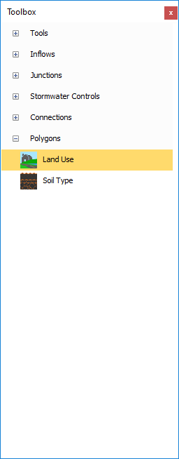

Toolbox
On the right-hand side of the screen we have the Toolbox which shows the functions and items that allow the creation of drainage schemes on the plan view. A default set of items are supplied with the software; additional items can be added through Object Templates.
An item can be added to the plan graphically by clicking and dragging the item to the required location.
